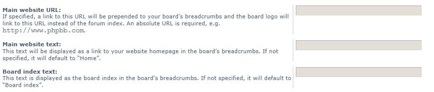

Have you in the ACP/General/Board Settings in Main Website URL what changed?

i verified, is blank
