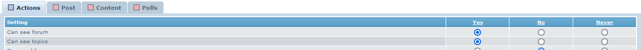

Posts: 1995
Re: Rcent Topics Permissions
Go to ACP/Permissions/Group forum permissions select guests and Select a forum, click on "Advanced Permissions" and set "Can see forum" and "Can see topics" on the Actions tab to yes.

ok - all forum sections are now marked with guest permissions to 'view forum' and 'view topic' - but still recent topics activated, does not show for guests.
Posts: 1995
You made this change too?
dart
Posts: 21
Joined: 1. July 2021 01:09
phpBB.com User: krill
Post by dart »
Yes I made that change too - now guests can see forum & Topics but still cannot see 'recent topics' in portal.

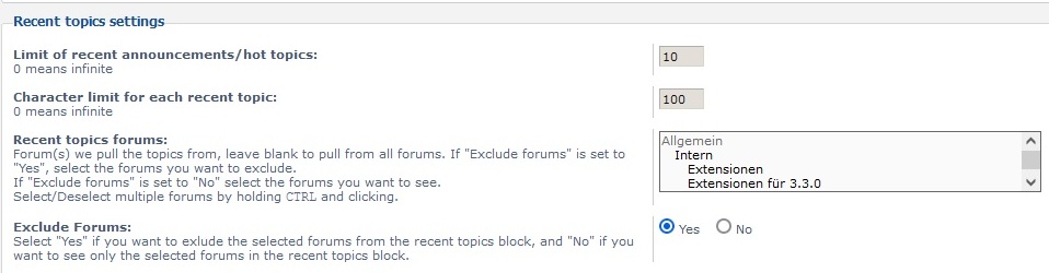

Posts: 1995
Have you made any changes here?
dart
Posts: 21
Post by dart »
The Portal recent topics I have does not show "Extension for 3.3.0" as is showing in your screenshot above.
