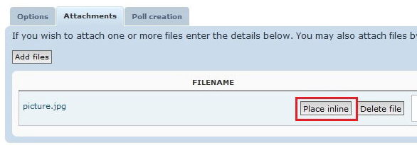

Re: Cannot load XML: Premature end of data in tag r line 1
You have to click on the button "Place inline".
If there is no description, then it's the attachment.html of your style. This has nothing to do with the portal.
