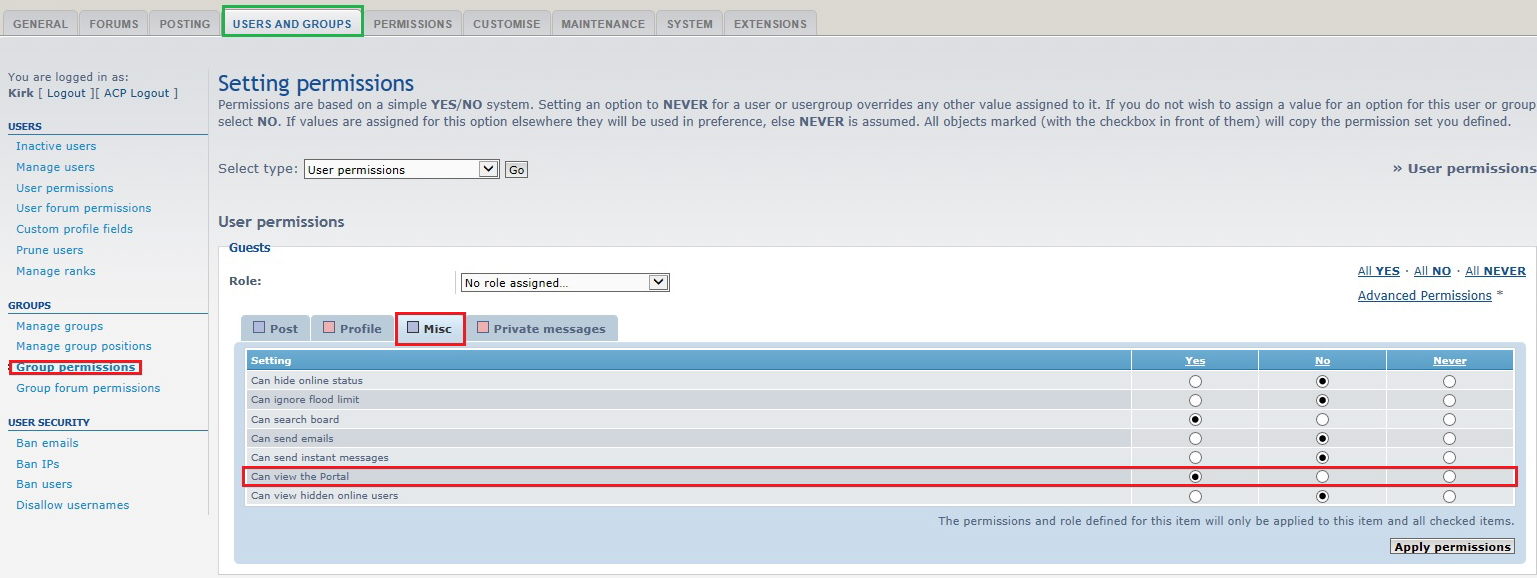

Guests have not permissions "Can view the Portal" Check this.

Re: How to ... Redirect to the portal after login / logout
Kirk, you 're really genious !
Thank so much for your help. I'll sleep quietly next night.
