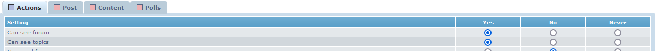

Re: Rcent Topics Permissions
Posted: 17. July 2021 15:56
by Kirk
Go to ACP/Permissions/Group forum permissions select guests and Select a forum, click on "Advanced Permissions" and set "Can see forum" and "Can see topics" on the Actions tab to yes.
Posted: 17. July 2021 20:45
by dart
ok - all forum sections are now marked with guest permissions to 'view forum' and 'view topic' - but still recent topics activated, does not show for guests.
