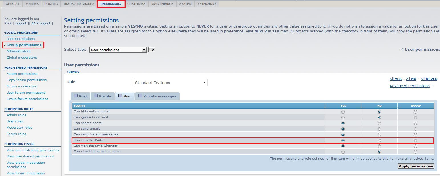

The permissions are set correctly for the guest user and group:

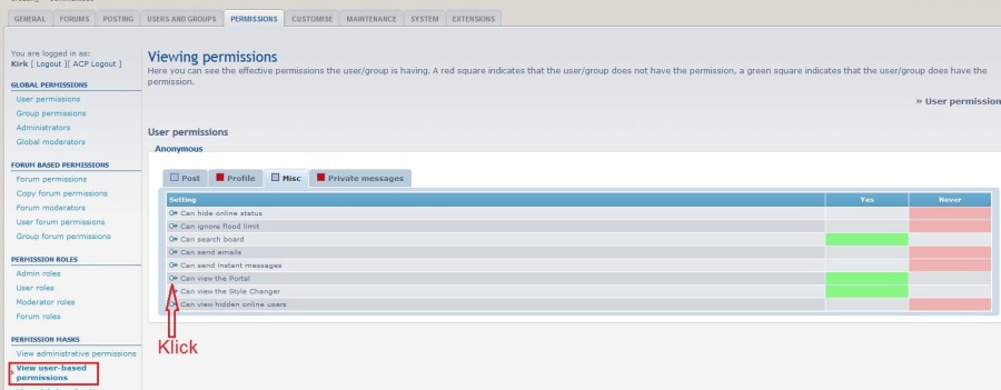

Go to ACP/Permissions/Permission Masks/View user-based permissions
Klick on " Select anonymous user", klick "View permissions"
