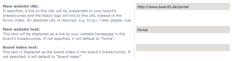

Here we go:
							- go in the ACP - General - Board Settings - and adapt your settings accordingly:
 -  navigate to the directory
root/ext/board3/portal/styles/prosilver/template/event/and delete those two files:
overall_header_breadcrumb_prepend.htmlandoverall_footer_breadcrumb_prepend.html -  add to your
.htaccessthis:Code: Select all
DirectoryIndex app.php/portal index.php index.html index.htm - purge your forum and browser cache
Re: Set Portal to be Default
Thanks!  That did the trick.
But let me ask you: It seems like just the modification to .htaccess did the job. What is the purpose of changing the settings and deleting the files?
ETA: Never mind. I see it now.
Thanks again!
Hi Keven
I did this but when I delete
it wasn't explained above, what happens if I don't delete those files ?
It locks me out with errors, but if I don't delete those files it works,overall_header_breadcrumb_prepend.html and overall_footer_breadcrumb_prepend.html
In the  "ACP -> General" --> purge cache
Ok I'm an idiot
when it locked me out of the site i thought it also locked me out of admin. section but it doesn't
I purge cache and it works
Thanks
