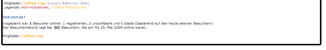

PeterS
Former Team Member
Posts: 246
Joined: 15. January 2008 08:41
phpBB.de User: PeterS
phpBB.com User: PeterS
Re: [Erweiterung] NV "Who Was Here?" in Portal
Post by PeterS »
ich bevorzuge diese Variante:
zuerst den Mod "who was here 1.0.0" kompl. installieren. dann
open portal.php
finde:
// output page
page_header($user->lang['PORTAL']);
davor einfügen
if (!function_exists('display_who_was_here'))
	include($phpbb_root_path . 'includes/functions_wwh.' . $phpEx);
display_who_was_here();
open /styles/dein style/template/portal/block/whois_online.html
find:
<!-- IF LEGEND --><br /><em>{L_LEGEND}: {LEGEND}</em><!-- ENDIF --></p>
danach einfügen:
				<!-- IF WHO_WAS_HERE_LIST2 -->
					<h3>{L_WHO_WAS_HERE}</h3>
					<p>{WHO_WAS_HERE_LIST2} ({WHO_WAS_HERE_EXP})<br />{WHO_WAS_HERE_RECORD}<br />{WHO_WAS_HERE_LIST}</p>
				<!-- ELSEIF U_ACP -->
					<p>{L_WWH_UPDATE_NEED}</p>
sieht dann so aus
Peter
