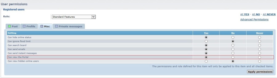

First, "Can Users View Portal" in ACP is not an option, I followed other support post address, but I do not get that option.

bearqst wrote:First, "Can Users View Portal" in ACP is not an option, I followed other support post address, but I do not get that option.
On ACP/Users and Groups/Group permissions/your Group/misc Can view the Portal
