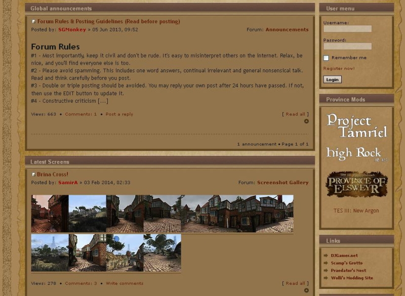

Having some minor issues after making some changes to my forum style. Basically I wanted to adjust the post profile area to be a fixed width.
I followed this quick guide. Which works fine as far as I can tell, everywhere except on the portal.
On the site http://provincecyrodiil.project-tamriel.com/ If you switch to the proCyrodiilWide style you will see the issue.
At first i thought it may be a problem with that style itself. So i tried it on my other forum http://highrock.project-tamriel.com/ and I get the same issue.
I'm sure it's something minor that's causing the issue but I just can't seem to see what it is.
Any help at all would be greatly appreciated. I know I'm using a slightly older version of the portal and I do intend to update it once ive gotten this issue resolved.
Thanks everyone, much appreciated!

The problem is that here:
Find and delete this :
.postbody {
color: #0F1415;
line-height: 1.48em;
margin: 0 0 0 191px;
padding: 0;
width: auto;

Re: Portal issue
Yes it isMordynak wrote:I have altered the board3 copyright, as in, I've moved it to the overall footer. Is that allowed?
Copy this _block_config.html to root/styles/proCyrodiilWide/template/portalMordynak wrote:I don't suppose you know of a way to increase the padding on the left side of the post contents?

Apologies for the delay. Adding the block config to the template did fix an issue I had with styling on the portal which is excellent!
However I still have one minor issue left. After making the profile pane a fixed size, the post contents are pushed right up to the edge of the profile information.
The best example I can give is if you view this topic
http://provincecyrodiil.project-tamriel ... f=4&t=1158
Compare the proCyrodiil style to the Wide style and you will see that the contents are pushed to the left, most noticeable is the attachments box.
Apologies if this is a phpbb problem and not a Board3 issue.
Thanks again for the help, It really is much appreciated!
