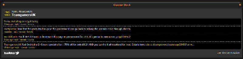

This is the code im entering, its just a twitter widget. ( This works on my test forum, running phpbb3 3.10 and portal 2.0.0b )
<script charset="utf-8" src="http://widgets.twimg.com/j/2/widget.js"></script>
<script>
new TWTR.Widget({
  version: 2,
  type: 'profile',
  rpp: 4,
  interval: 30000,
  width: 'auto',
  height: 180,
  theme: {
    shell: {
      background: '#333333',
      color: '#ffffff'
    tweets: {
      background: '#000000',
      color: '#ffffff',
      links: '#ebc507'
  features: {
    scrollbar: false,
    loop: false,
    live: false,
    behavior: 'all'
}).render().setUser('TeamgamersUK').start();
</script>

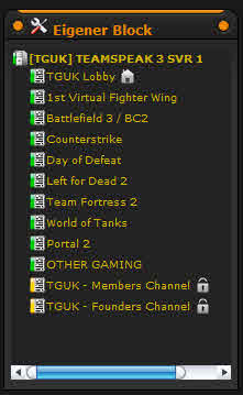

I have added a custom block on the right without a problem though, which also has BB Code turned off.. ( this is below if it helps )
<iframe allowtransparency="true" src="http://www.teamgamers.co.uk/ts3wi/tsviewpub.php?skey=0&port=9987&showicons=left&bgcolor=232323&fontcolor=d0b20b" height="320" width="230" scrolling="AUTO" frameborder="0" marginwidth="0" marginheight="0" name="pa">
Your Browser will not show Iframes</iframe>

I have a "work around" to cheat the problem.
I have added the twitter code into a blank php file, then just added an iframe, with the file's address in.
This works, but I shouldnt have to do this, as it wasnt necessary to do it this way in the previous versions. I used to be able to add the raw code straight in. Unless this is the way you intend to do it from now on? However if this is the case, then I shouldnt get the error though...
So this is what I have done:
( but this is NOT a solution )
1, created a file, example: custom1_iframe.php
2, add your desired code straight in the above file for example, the twitter widget code.
3, added the code below into the custom block field.
<table>
        <iframe src="http://www.domain.co.uk/custom_blocks/custom1_iframe.php" width="100%" height="300" frameBorder="0" SCROLLING=NO></iframe>
This works perfectly, but as I said above, I dont understand why im getting the internal server error if I just enter the code into the custom field instead, which used to work.
