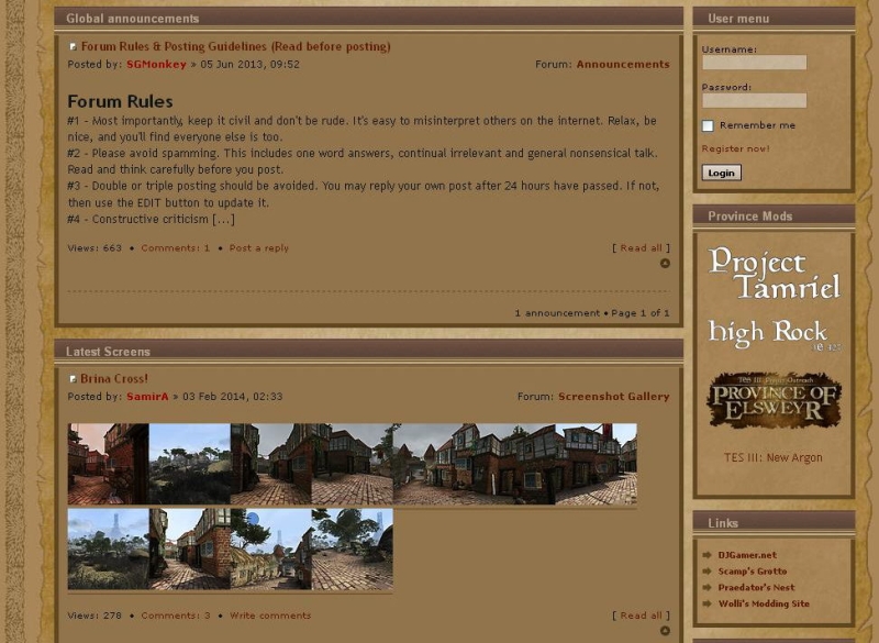

Having some minor issues after making some changes to my forum style. Basically I wanted to adjust the post profile area to be a fixed width.
I followed this quick guide. Which works fine as far as I can tell, everywhere except on the portal.
On the site http://provincecyrodiil.project-tamriel.com/ If you switch to the proCyrodiilWide style you will see the issue.
At first i thought it may be a problem with that style itself. So i tried it on my other forum http://highrock.project-tamriel.com/ and I get the same issue.
I'm sure it's something minor that's causing the issue but I just can't seem to see what it is.
Any help at all would be greatly appreciated. I know I'm using a slightly older version of the portal and I do intend to update it once ive gotten this issue resolved.
Thanks everyone, much appreciated!

The problem is that here:
Find and delete this :
.postbody {
    color: #0F1415;
    line-height: 1.48em;
    margin: 0 0 0 191px;
    padding: 0;
    width: auto;
}Code: Select all
margin: 0 0 0 191px;Gruß Udo
